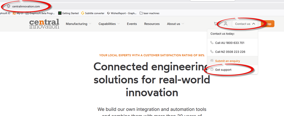

Go to their website and they have links for support.
I see you are from New Zealand.
Wouldn't you be one of their clients?
If so you should have a MyCI account, you can log in here ...
https://myci.centralinnovation.com/People/Login?ReturnUrl=%2f
