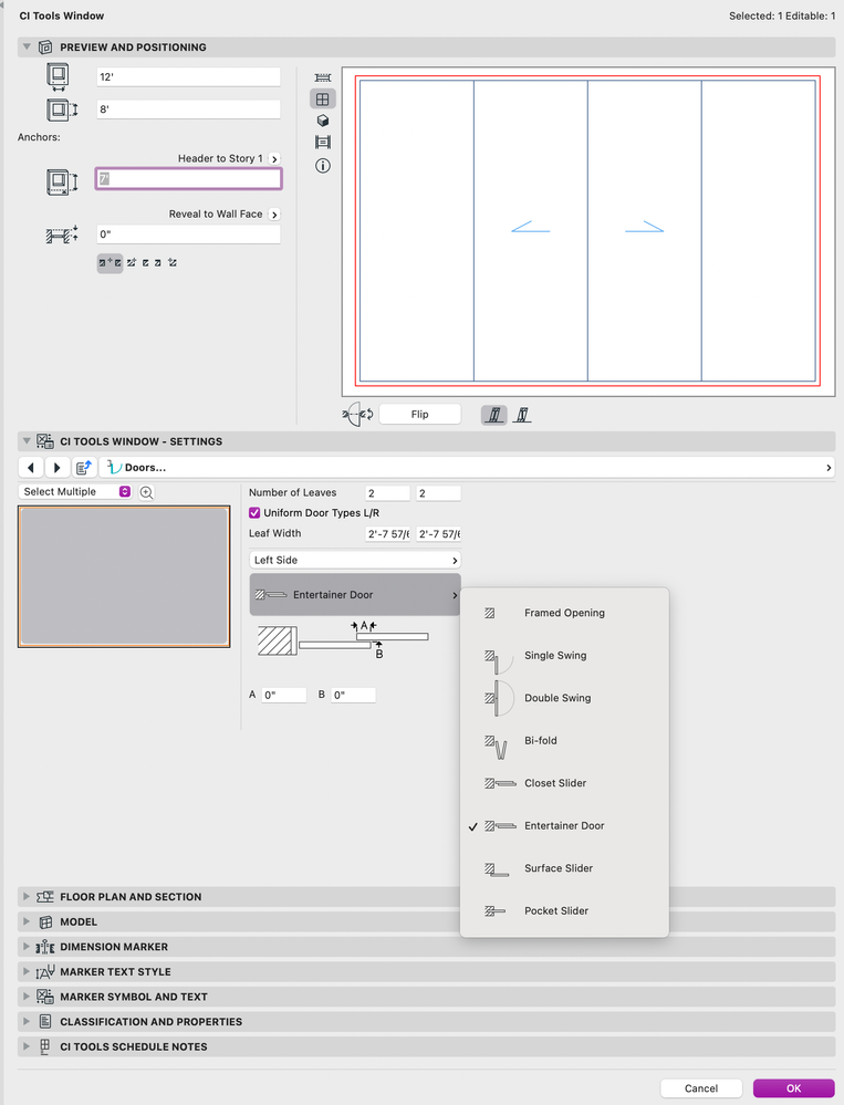

Patrick M
so if it has to be a window, you can make it a door, use an entertainer door as the operation, with 2 leaves on each side. You can do the same thing using the c/i door, rather than the window inserting a door.

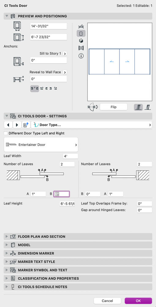

using c/i door instead of window:

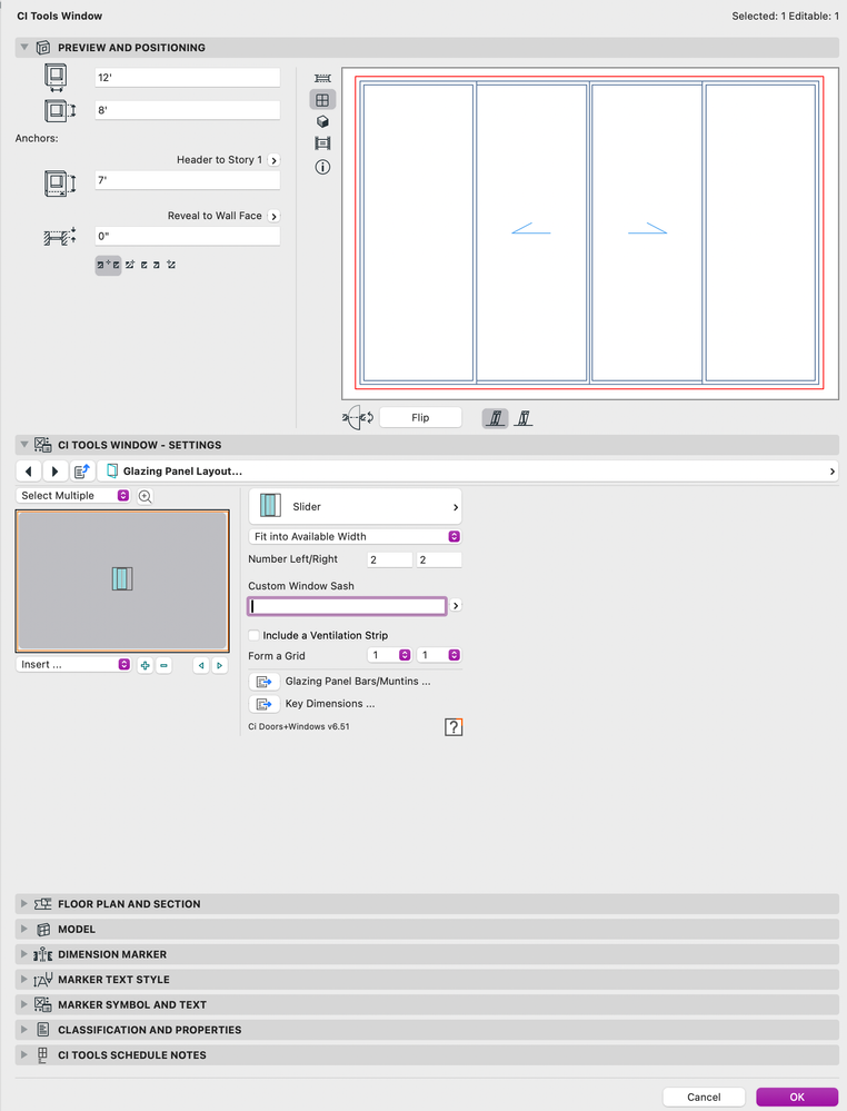

or, using a window as a window (without door operation):

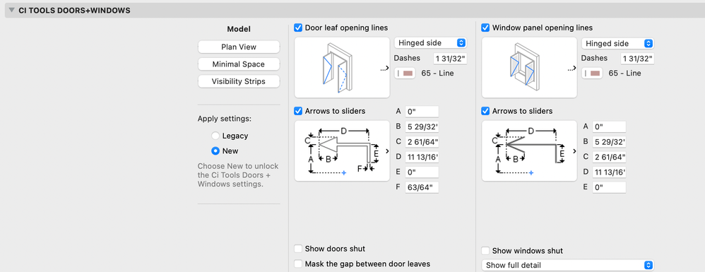

if you have jumped all those hoops, and it's just the arrows showing incorrectly, make sure all your window settings are "By MVO", then check this in your MVO settings (hinge vs opening setting):
