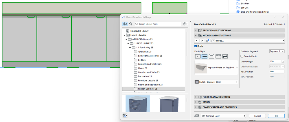

Hi! how do I remove these lines ? It is already painful that archicad cabinetry library is not customizable enough for designers so I had to create 3 cabinets instead just ONE with different segments and types... Finally I build the 3 cabinets (already a painful experience) , now these lines shows everywhere! I turned off everything in setting and it is still there. there are connected perfectly and have same finish, so it should hide the lines.... I tried also different display orders but nope, nothing works.

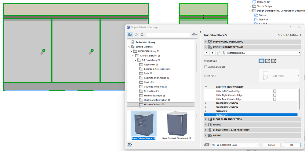

- Floor plan shows ok, all seamless, the cabinet edge visibility on side is turned on for a reason and must stay however the other side is turned off and should not show anywhere and especially not in countertop and baseboard.. I mean... I would have to literally explain the carpenter, piece by piece please don't make cuts, it's my software... and no not a free one.
- regarding floor plan, note worth saying, that countertop visibility also does not show, neither backsplash is ... also can't see each line to be customized for one or another (cabinetry/drawers openings, backsplash, carsas...)

when placing cabinets side by side so the sides touch....
In Archicad 25 using the Archicad 25 library; the benchtop, kicker and back splash back automatically join.
In Archicad 27 using the Archicad 25 Library; the benchtop, kicker and back splash back automatically join.

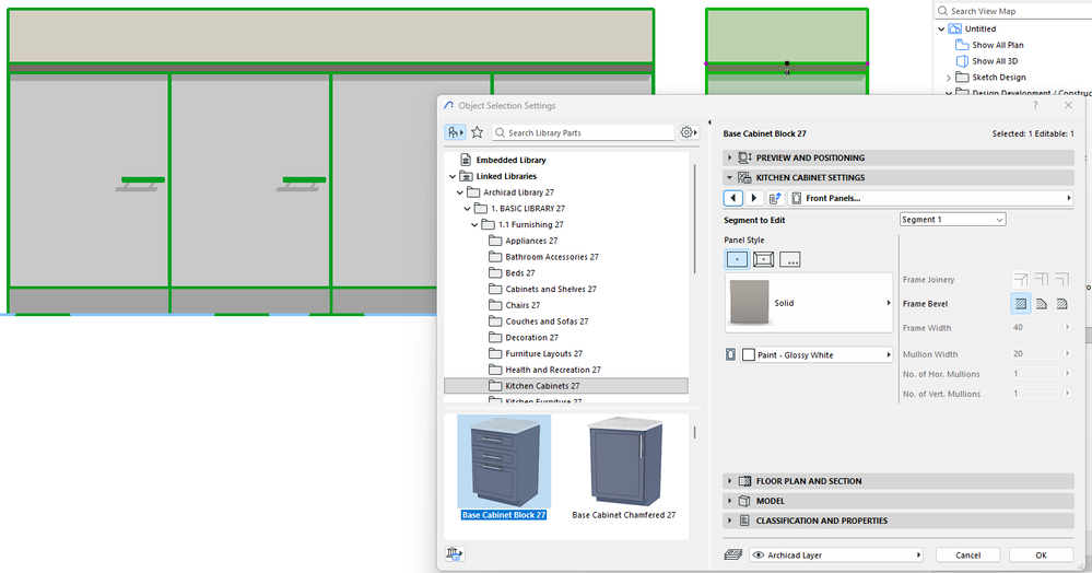

but in Archicad 27 using the Archicad 27 library; the benchtop and back splash back automatically join, the kicker doesn't join anymore.

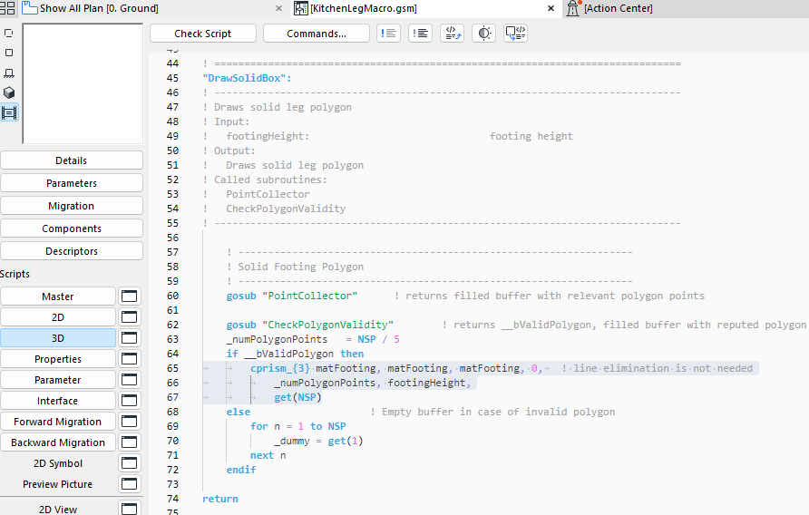

the only change I found was this bit of code;
So somebody did a booboo somewhere....

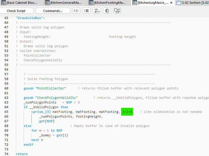

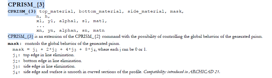

The fix is to add the line elimination mask  to the cprism_{3}.
you will need to unpack the library, open the "KitchenLegMacro"
change to mask from "0" to "1+2+4" (technically its just a side connection, so just the 4 should work)
repack the library,
and bingo
it is fixed.

I found it by opening the cabinet object,
that lead me to the KitchenGeneralMacro,
that lead me to the KitchenFootingMacro,
that lead me to the KitchenLegMacro.
