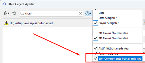

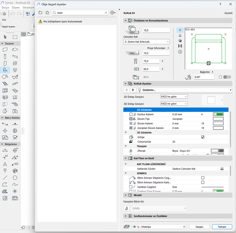

Hi everyone,
When I searched for an object in Archicad 27, it was also searching in the bim components portal and showing me the results, when I do the same search for Archicad 28, I don't get any results. Has there been a change in this feature in Archicad 28 or is there something I am missing?
Btw in both images, the search option on the bim components portal is active.

Your comment made me think and I just checked it again. Actually, I am getting a yellow warning icon, and when I hover my mouse over it, it says there was a connection timeout. If I go to bimcomponents.com in my web browser, the site loads in a few seconds. So, yeah, there seems to be an issue with the connection:
But, I got curious, so I started testing:
1. Tried searching from my desktop, Archicad 28, using my broadband internet connection - the error occurred.
2. Tried searching from my desktop, Archicad 27, using my broadband internet connection - the error occurred.
3. Tried searching from my desktop, Archicad 26, using my broadband internet connection - the error occurred.
On my laptop:
4. Tried searching from my laptop, Archicad 27, using my broadband internet connection - the error occurred.
and then
5. Tried searching from my laptop, Archicad 27, using the internet connection of my mobile phone - the error occurred.
So, it looks like it doesn't matter which computer I use, which Archicad version I use, and which internet connection I use, the error occurs.
That makes me think there must be something on the bimcomponents.com side of the connection that causes this issue.
