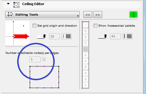

Hi Endre,
I'm having some problems with the ceiling editor. I can not edit the nodes on the plan. Also, the "Number of editable node(s) per edges" option does not seem to work.
It doesn't matter if the "Set grid origin and direction" option is checked.
ArchiCAD 26; Windows 11; Intel i7-10700KF; 64GB RAM, GeForce GTX 3060
Jere
Notice on the pet palette that the "move node" option is not available. I've tried having the arrow tool active and the object tool active. I've tried double-clicking on the nodes as per the YouTube video. No luck so far.
Otherwise, I've enjoyed the object.
Two requests:
1. Add the ability to incorporate custom panels
2. Add the ability to include 1x4 light fixtures into a 2x4 grid or 2x4 light fixtures into a 2x2 grid.
Any of the below two cases happening to you?:
After dragging one of the intermediate nodes on the sides of the Ceiling Editor object, the Number of editable nodes per edge field will become disabled for the edited Ceiling object, indicating that you cannot make changes to the number of available nodes from this point.
After the Ceiling is placed using the Interior Wizard, the Number of editable nodes per edge field will become disabled since this fields does not apply in case of Ceiling objects placed using the Interior Wizard.
