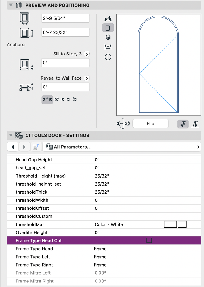

I have seen this in c/i before... I believe C/I's solution was to 'repair doors' (which I dont think actually does anything).
I remember fussing with the 'all parameters' until I got it to work. I did not document what setting I had to toggle or update though, so I'm just rambling unhelpfully, I guess.
Tuesday
- last edited
yesterday
by
it may been this one... but it's not actually making a difference in my current attempt to replicate the issue.
yesterday
Thank you for pointing me in this direction. I looked through all of the parameters, but I wasn't able to locate "Frame Type Head Cut". I'm using the C/I Doors Exterior and Windows tools.
