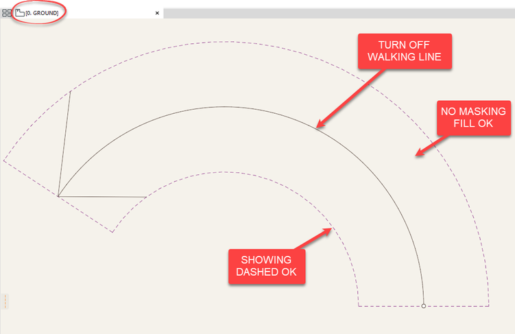

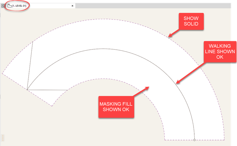

To replicate what I'm trying to achieve:
  1. Place ramp on Level 01, and set to show on Home & One Story Down.
  2. Turn off break mark, side flanges, and any text.
On Level 01, I want to show a solid outline, masking fill, and walking line.
On Level 00 (Ground), I want to show a dashed outline, no fill, and no walking line.
I can't achieve this with the current Curved Ramp 26.  See attached screenshots for what I'm trying to achieve.

Hi Bruce Walker,
Thank you very much for the screenshots and further explanation.
So if we understand correctly, the issue comes from the object not supporting different appearances below and above the floor plan cut plane when we switch the break mark off.

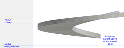

Hi Bruce Walker,
We agree that this use case needs a better solution and we consider one in a later version.
But in the meantime maybe this finer workaround might help overcome the issue:
The cut plane height needs to be set a little bit above the lowest point of the object, on the lower story. This can be 0 if the object is placed to -100, or +100 if the object is placed to 0. If you place the object on the upper story,  you need to calculate this height based on level height, object height, and placing height on the home story. Regardless of placing the necessary height needs to be set on the lower level.
