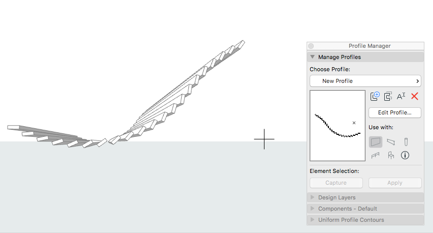

I’m a long time ArchiCad user but I can’t find a good solution for these two dilemmas:
A)
A curved ceiling made up out of thin wooden beams (image).
The problem is not to model this, but how to effectively change the curvature during design phase without having to model it over and over again. I’m aware that a Rhino-Grasshopper connection could solve this parametrically (a controlling spline and all the beams perpendicular to this) but is a similar solution possible within ArchiCad?

A) since there are so many ways you can quickly model it, why do you need to keep it adjustable? Tweak the complex profile per a spline you draw in a section seems like a good way to get the exact curves you want. When ever I tweak a curved complex profile I use a wall and the magic wand to follow the spline. Then explode the wall and consolidate the fills. Then use that fill in the complex profiler.

A) I'm not sure I understand your solution entirely. How do you tweak a complex profile via a spline in section view?
Just as a test I tried making a curved ceiling as a complex profile and have the wooden beams follow a spline, but it's not entirely correct. The beams don't align themselves tangential to the spline.

You can't.
Are you using the new methods for distribution/multiply along a spline that we can do in 21 now? This might be a little different than before.
I don't think you can make a 3D object you can adjust like a spline for new curves, other than the limited way you can do it with a morph. If you convert that Profile to a Morph you can adjust its curves with Box Stretch if that helps.
If your were to use a morph that is just a single part you could use the Box Stretch to adjust the curve in 3D, but not with all of the control you probably need.
You can probably make a new Profile with the new curves/spline faster than you can model each part individually. By update the Profile I just mean that you open it, paste in the new fills and save it again.
This does not make anything adjustable in 3D like you would adjust a Spline, but I don't know why that kind of adjustment would be important other than for instant 3D visualizations. Wouldn't you prefer to have it modeled per some thing more constructible and documentable than free-form? You will want to make those curves to some dinmensionable path. Some arch and pivot points that you can show in a detail. Something the builder can reproduce on the jobsite exactly per plan.
I think the solution will be in finding a clever way to model it rather than finding an element you can adjust in a 3D view.

Idea of a stretchable 3d part to help see what the approximate shape/curve should be is valid. It seems like there should be an object out there that would do this. The only solution to that I have would be to convert that beam or wall Profile in to a morph and stretch that around. The down side to that is that it's too late:) If you already made a Profile for that ceiling you don't need a toy to help you figure out the curves of the ceiling.
In this image are two Profiles saved as beam and wall and converted to a morph so they can be stretched with the Morph Box Stretch.

initially I thought the curves you were talking about were going the other way, like this.
Steve Jepson
what you want to do is something more like this where the wood is perpendicular to the curves - right?
