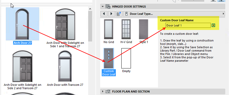

If I'm right, this isn't a new issue, but still a vexing one.
Seemingly at random, computers in the office will *forget* all of the Custom Door Leaf options. Screenshot is from my Windows laptop, but the same thing happens on Mac desktop.
I can *create* custom door leafs that then show up as options for other computers in the office, but my options remain empty. I created one again today as a test, and then checked on the Principal's Mac, and, lo and behold, there it was.
It's clearly a library issue, as the computers don't seem to be looking in the Embedded Library for door leaf options (there are 40+ of them). In each instance, a computer that initially showed the options later decided not to, and to register the door leaf options as empty.
What workaround / fixes have folks come across?

That's where I'm admittedly confused. If it can *write* door leafs to the embedded library for the file (which is a Teamwork Project), why can't I then see the very leaf I just created? Other machines that open the Project can see the leaf I created / library list...
It's odd, and apparently not a new problem.

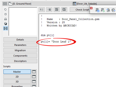

There is a macro called "Door_Panel_Collection" that is part of the default library.
When the libraries are loaded (Archicad is opened), this object reads the custom door objects in the embedded library (and I think other loaded libraries as well), and adds them to a list in the Master script.
You mention that you are on teamwork.
I wonder if you do not have the correct permission to alter GDL objects, so this macro is not being amended as it should be.

ETSaum
It's frustrating, because I can even see all of the custom door leafs listed in Library Manager. It just doesn't give them as an option for any of the doors for which I've created custom door leafs.
It's true of any project I open on this computer. Custom door leafs are just greyed out.
So it's as if it refuses to load part of the Embedded Library.

Having the door leaf objects in your embedded file should be enough.
When you load the default library, the 'Door_Panel_Collection' macro is supposed to find all of these door leaf objects and add them to the list in that macro.
It means it has to be able to write to that macro.
You mention you are on teamwork, maybe you do not have permission to write to the library (amend library objects).
The macro can be found here ...
Object Library 27\3. MACROS 27\Custom Object Macros 27\Collection Macros 27
Browse in the Library Manager to find that macro in your loaded library after you have saved a new door leaf object.
Check the modified date of the file to see if it has today's date.
If it doesn't you know there is a problem with your permissions.

I appreciate the further insight. The custom items are all saved as individual line items in the Embedded Library, rather than in the folder structure of the Archicad 26 library. I can see all of the custom door leaves in Library Manager, including every single one I've ever created. There's no macro; just the individual line items.
In the Archicad 26 library, the Door Panel Collection macro hasn't been updated in almost two years.
So it's clearly writing to the Embedded Library, not the Archicad 26 library. But when trying to place a door leaf I just created, it seems to be trying to pull it from an unchanged Archicad 26 library.

Yes, the door leafs you create will be in the embedded library.
But the macro in the library should be getting updated.
Maybe because you are using the default library and it is an .LCF file, it can not update.
My library is not an .LCF
I thought with an .LCF, it also saved this file into the User folders of your operating system.
The file there I think might override the one in the library.
I will have to do some experimenting to find out exactly what happens.
