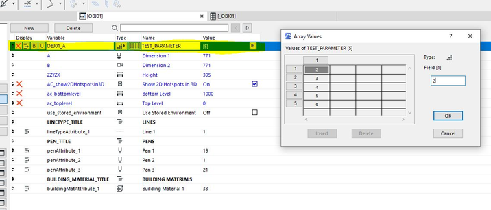

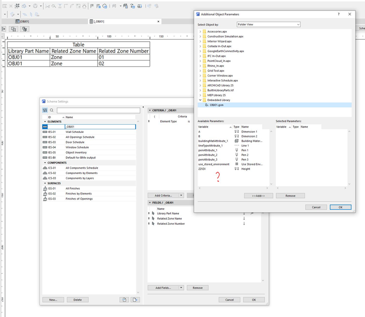

I want to call a custom object parameter into my schedule and I can't seem to find a way to make it appear in the 'Add fileds -> Library part parameters -> Availabe parameters'.
In my example I am looking to call 'TEST_PARAMETER'.
Help?

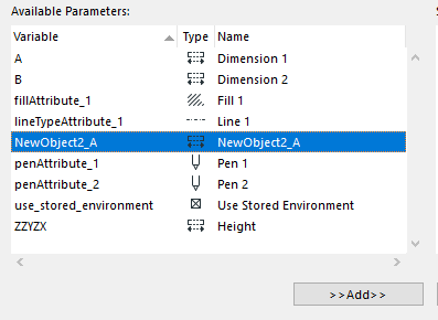

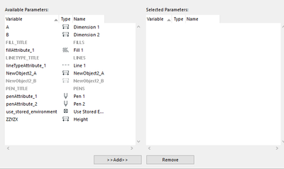

Arrays are Shown greyed out in Archicad 22, and are unavailable to be used, but shown.
Arrays are  not Shown at  all in Archicad 24 or above
if you hide the parameter (the red cross beside the parameter in the Parameters list) then it does not appear in the list of available parameters.

you can use the "hideparameter" command to hide the parameter from the user, but still have it available for the schedule/list.
