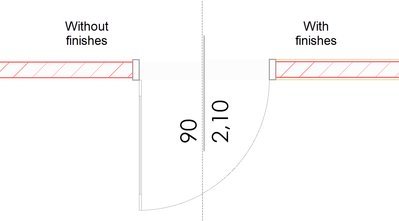

I am doing residential buildings in Austria, it is standard here to document floor plans without showing wall finishes, ie brick internal wall, no plaster either side. I can use the different model views and composite walls to control this - with 10cm brick as the core and 1,5cm of plaster either side as finish, for internal walls, setting model view to 'without finihses'.
When I model a door in this wall, the frame wraps to the invisible finished face of the wall, but in reality, the door frame is installed on the brick core, and the wall is hard plastered up to the frame. I can reduce the frame thickness to zero, but it doesnt represent correctly.
Is there a way to have the door frame thickness respond to the wall core, rather than the wall finish (regardless of model view options)? Or do I have to use solid brick walls and accept that the internal spaces will be 3cm smaller than documented?

Correct display of door frame wrapped to wall core in plan - modelled without finishes. in 3d views will show frame step and results in misaligned walls.

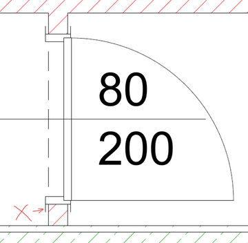

modelling with wall finishes, hidden using model display options - door frame wraps around ghost of finished wall thickness

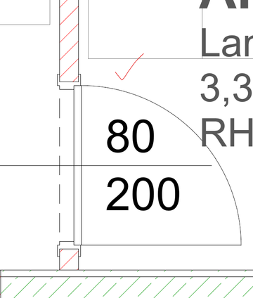

setting frame depth to zero to simulate door frame face sitting flush to hard plaster. correct in model but not in plan, doesnt show thickness of frame hugging core.

To my best knowledge what you are looking for is not available in the doors included in the basic library...
I think the closest you can take it is by turning the casings off and setting your frame to block style and oversize them...
Or by modelling the core and then the finishes separately... And I've just opened up a whole new can of worms with this...
(I understand that this is quite a bit of overengineering... and a metric ton of extra modelling and model maintenance work...)

Uhhh, it's not really about GDL, is it?
@Toni Mayerhofer I think the real question here is why would you want to show the wall without finishes but with the casing on in the first place.
Why not reduce the LoD in the MVO? I think that would be a better approach.
Or change the "Zargentyp" to a "Blockzarge" instead of a "Umfassungszarge" – nothing's wrong with the display in my opinion.
