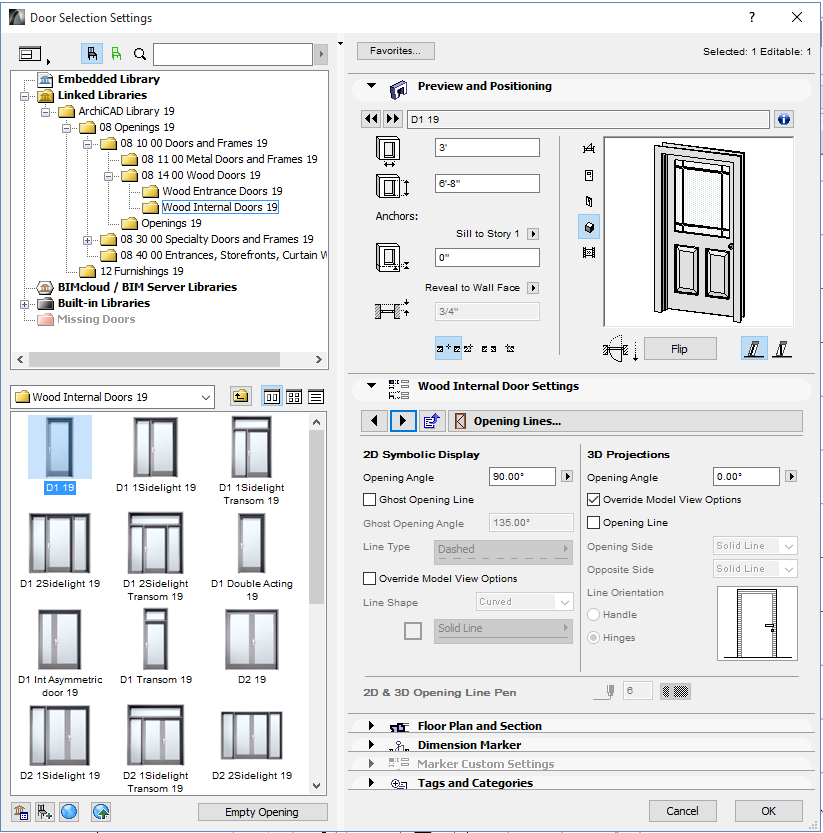

What would cause this ?
I have some doors that will not display closed in 3D and open in 2D.
Notice in the picture that the 3D setting for door opening is 0 deg. but is shows open the same as the 2D setting. ??
The 3D setting for this can not be edited either. What could be the problem ?
It seems to work fine in a fresh Template. I have tried to reload the library but it is still the same problem with some doors. ??

I am not too familiar with these doors as I don't use them.
But I seem to recall an option that says 'set 3D opening the same as 2D'.
Doesn't seem to be in the settings you show so maybe it is in the Model View Options.
Or tick the override MVO option and see what you can do.

It turned out to be a problem with library migration.
It never occurred to me to migrate the 19 library. I did and then I was able to delete the door and place it again. Now the option to show the door open in2D and closed in 3D is available again.
