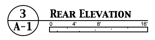

Jocelyn wrote:Works here. When I explode the title part, the scale bar resolves (not surprisingly) to little chunks of "Solid Fill" I'd say the ever-helpful Laszlo is on the right track. One way to test his hypothesis is to look at other library parts that you know used to have Solid Fill. If they have gone speckley then the issue is probably with the Fills assignment.
It's currently showing as something speckled... Concrete? Stucco? Sand? Not 100% (which is what I'd prefer, thanks).

Jocelyn wrote:If you Use Latest Project Settings, that is not a fresh start because you continue using the attribute settings of the previous file that was open just before that, which file can contain references to attributes that are totally different from the default ArchiCAD attribute assignments. However, all ArchiCAD default library elements refer to attributes the way they are in a Template file.
Chazz - I can see where you're coming from, but.... This was a fresh-built file started from nearly zero. New File>Use Latest Project Settings, and I'm the only one to have worked in it. And I'm fairly certain that the latest project had solid fills in the graphic scale.
