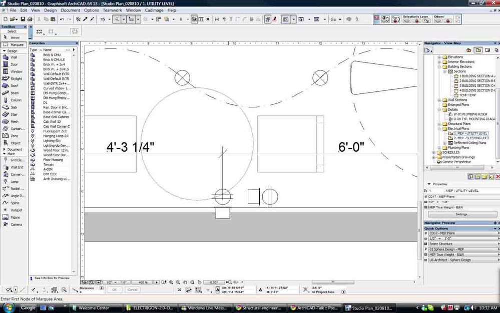

Does anyone know if there is a way to rotate the 3D object symbol of a light switch or outlet independently of the 2d symbol. I'm having a problem that when the 2D symbol is placed on the plan-in proper orientation, 3D object is placed at a 90 angle to the symbol. see attached image. Any help would be appreciated.

Receptacle Duplex out 13, but i'm having the same problem with most of the other electrical symbols as well.

The problem is that the 2D symbol is rotated 90˚ from the US convention (the prongs should be perpendicular to the wall, not parallel), as you can see the junction box in plan, and this conforms to the location of the outlet in 3D (the 2D and 3D are correlated, but part of the 2D symbol is wrong).
In this case, the 2D fix is simple (as GDL fixes go). Open the library part, then save a copy with a new name (so you are working on a copy). The circle and two lines (prongs) are called as a fragment from the 2D Script, and this fragment is drawn in the 2D Symbol window. So go to the 2D Symbol window and you will see the circle and two prongs, select them, and rotate them 90˚ around the center of the circle. Save the altered library part, and the 2D symbol will conform to US standards while the 2D and 3D are still correctly correlated.

Thanks Don. Your solution was exactly what I was looking for. One last question, since the new object is saved to the embedded library, how would you go about replacing the original object with the new in the Archicad 13 LCF. Or should I just create a separate LCF file with the corrected symbols and load that separately.

Create a new part and place it in your office library which loads for all projects.
