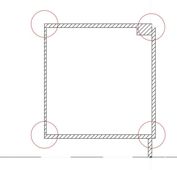

I would like to know if it is possible to prevent solids in gdl from intersecting so that when I create a section I see a line between the solids ie:
I created this with PRISM and PRISM_ and I don't know if I can do it with masking!

This is what I want it to look like

No intersection in section is done by material/hatches. You get the line only by tricks like e.g. a little gap.
Oh, ok, will try to find a workaround than thanks a lot!
You can use two fill types (ie different names) with the same pattern. These will not be automatically cleaned up in section.
