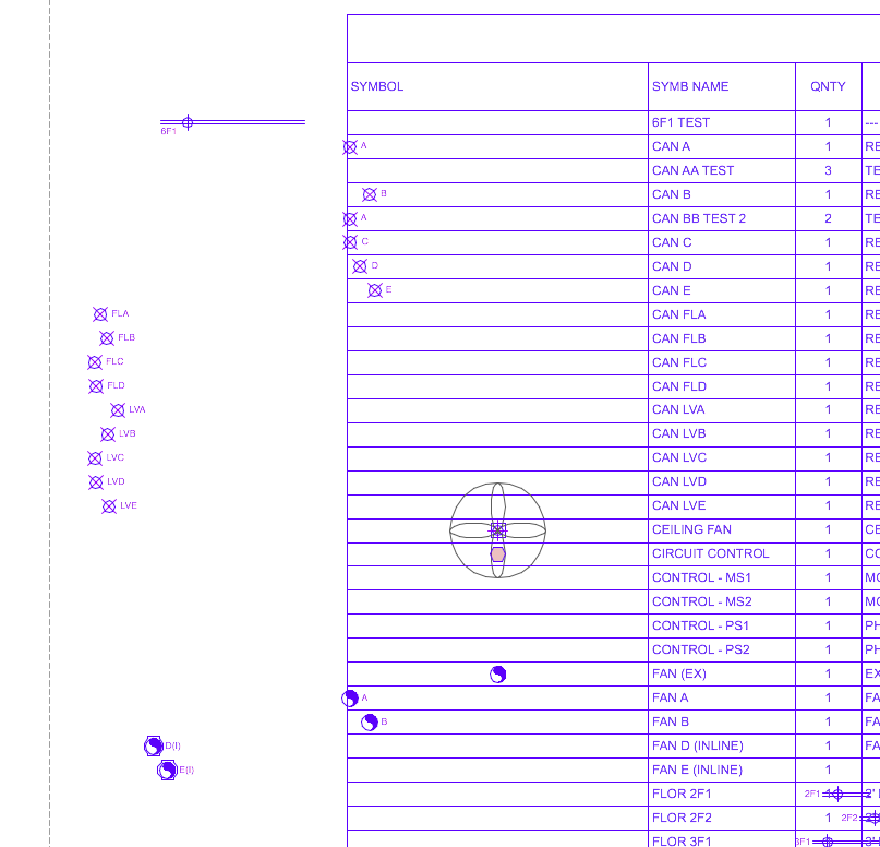

In our electrical schedule, the first field is the symbol which has always shown up correctly, neatly aligned in the center of the symbol field box. Now for some reason, they are all over the place horizontally (see image)
Does anyone have any idea why this could be happening and what I can do to fix it?

I have noticed this as well.
Your objects are rotated and/or mirrored on the plan.
Of course this may be deliberate so you may not be able to change it.
It may be affected by the way the object was scripted - ie distance from the origin - which makes it move way outside your schedule.
But even if scripted at 0,0 then the rotation and mirroring still makes the image look wrong although it stays in the schedule.
Also when you have multiple instances of one item and you group like objects so they count as a total (rather than individulally) it will use the image from one instance of the object and it is a bit of pot luck to find out which one it is.

Looking closer at your image it may not be a rotation or mirroring problem (I would still check in your plan though).
What settings do you have for the preview cells in the schedule?

Thanks for the help... does not seem to be related to the placement on the plan (one symbol placed exactly as the part was saved still has the same problem). And the settings for the preview seem to be okay. If I click the "reduce preview to fit" button, it reduces them and forces them to fit in the cell - this is at least better, but the scale is way off. It clearly has to do with some defined origin point.
Another thing - the symbols without text show up fine, like FAN (EX). This means that it must be some origin point associated with the text.
Any idea how to fix that?

Another test. I tried making a new library part directly on the plan origin point. This had no effect, it came out with the exact same displacement (in the schedule) as the library part that was made off of the origin point.

Check the scale that you have for the schedule.
You want it to be the same scale as you view the objects in plan.
