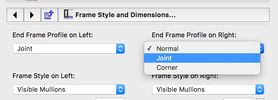

Eduardo Rolon
I think GS renamed it to "JOINT"

Bill
Thanks, but that controls only the left and right, and I need to control the top and bottom, as well.
I can get around it by constructing the multi-story wall as one element and then placing a multipaned aluminum window in there. However, I know that I have often wanted to 'split' the wall into different stories and it was nice to be able to have part of the window in the one wall and another part in the other.
I tend not to use the curtainwall tool because 1) it was seemed difficult to use, 2) it couldn't schedule associated doors, and 3) a punched opening like this isn't really a curtainwall, but it's honestly been a number of years since I've used it, maybe I'll look at that again, can it gang members, as well?
