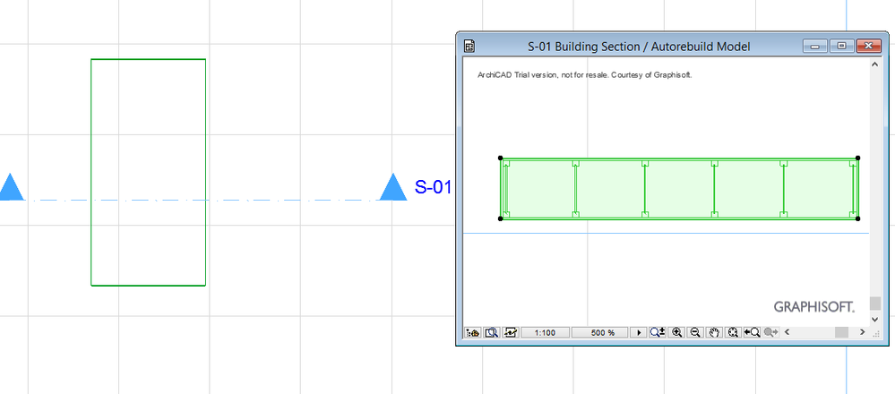

Unfortunately I'm not able to post the object on here as it's a commercial object but I have attached a couple of pictures showing what is happening when I take a section through the object (a prefabricated timber roof panel that has been scripted to be structurally correct).
The first image shows what I get if I take a section through the object (just the outline) and the second one shows the same but with the object highlighted. Ideally I would like to have the internal structure showing in the section view without having to highlight the object.

It appears that you have two planar elements to form the top and bottom of the assembly and a bunch of joists/rafters inside. However, when you select the whole object, there is also another element that fills the whole space between the top and bottom surfaces. I suspect that this is your problem. Unless you do as Oliver suggests, ArchiCAD will merge all the similar fills which seems to be the effect you are seeing.
Better still comment out, or turn off is some other way, the other element and the details should show up fine.
