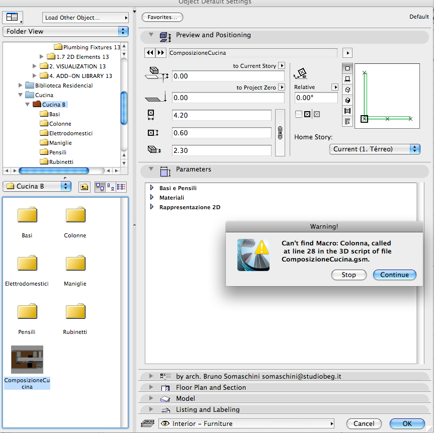

Help with a library object, please?
I dl a very nice Kitchen object from Bruno Somaschini.
But I cannot get it to work!
The file is made like the following:
Folder Cucina ---> Folder Cucina B
--->Folder Macro B
I did put the entire folder with the two folders in my Library, ok?
I don't know why the massage keep appearing.
What I did wrong?

Good job Laszlo. I made almost the same correction to the object, on this post: http://archicad-talk.graphisoft.com/viewtopic.php?t=31805
I did non noticed that there was a duplicate request here.
The only difference, as I can see, is that I also changed the word "Colonna" with "---" to denote clearly that in that situation the parameter for the "hanging cabinet" (I don't know the English word for Pensile) is not used, because the "lower cabinet" is too tall.
Edit:
Not so good, sorry. I just discovered that you modified only one of the six CALL statements.
The error can happen for the parameters from gs_pensili_1 to gs_pensili_6 although it is more common to have a "tall" element at the beginning (or at the end) rather than in the middle.

Yes, you are right, Roberto.
So, your fixed object should be used because in that all 6 CALL statements are fixed, not only the first one like in the one I "fixed".
Thank you ,both.
