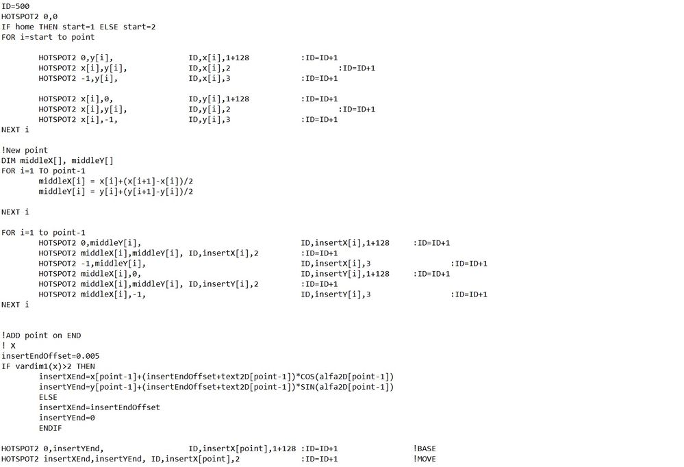

I have problem with to move text2 via HOTSPOT2. I create hotspot, but if i put more points, so crash it and show me only (.) I try what it do this problem and this do only, if hotspot2 on text2
HOTSPOT2 moxe,0,30,moveY2, 1+128
HOTSPOT2 moxe,-0.1,31,moveY2, 3
HOTSPOT2 moxe, moveY2, 32, moveY2,2
HOTSPOT2 0,moveY2,33,moxe, 1+128
HOTSPOT2 -0.1,moveY2,34,moxe, 3
HOTSPOT2 moxe, moveY2, 35,moxe,2
ADD2 insertX+moxe,insertY+moveY2
ROT2 alfa2D
text2 0,0, STR (text,2,0)
DEL TOP

Can you show the whole code? Now it is hard to find the bug.
āA winner is just a loser who tried one more time.ā

If this is for the polyline script (as it looks from the screenshot), it would be hard to find the bug with just that part of the script (is it a subroutine? is it in the middle of the 2D script? etc); but for starters I would not use DEL TOP as you might be breaking other things.

The Hotspot2 ID:s must be unique. Now you have used integers and two different parameters. Some overlapping can take place now.

IDs 500+

Between lines "*****THIS I TRIED" and "*****but not working"
I can see parameter "bod " and integers 30-35 used as ID:s

I tried make new ID = bod
bod=50000
:ID = ID+1 = :bod= bod+1
I tried change ID...that to avoid potential collisions in ID.
