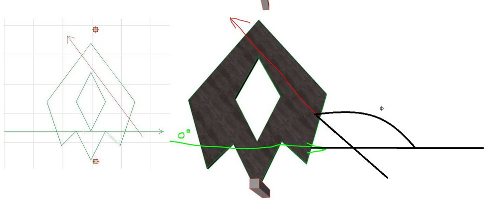

It example showes my trouble).
When 'angle' is 0, direction of texture - unpredictably (red arrow).
I have to make the texture direction in 3d coincide with the direction of hatching in 2d (green arrow).
But there is an angle between the 0 and the red line. Let's call it phi.
You measure how much phi is. The dirty and quick way to measure this is to add in several values for "angle" and see what angle value makes it line up with your red arrow.
This value is then your phi.
Then in your code that angle2 = angle - phi
and angle2 is your new angle variable that you call in your texture definition. That is the angle the texture will have to make sure that it lines up with the green line.

Note:You can then still change the angle of the texture by changing the "angle"-value and it should line up with your green arrow. The 135 is just an educated guess for phi based on your drawing

phi will be static. The offset between the angle and the green line will be constant.
So measure it once and it should work. The direction that the hatches are drawn will be guided by the "angle" parameter.
As long as your offset ("phi") is correct your texture should follow the hatch pattern.

I noticed that the texture lies perpendicular to any side of the contour.
The angle could be obtained from the points of this side.
But how ARCHICAD chooses this side of the texture binding for EXTRUDE I do not know (.
In short, it is necessary that as in hatching in 2d:
set the angle from 0 and go texture there).
My guess would be that the texture would be perpendicular to the longest side of the extrude.
But the sides of the contour are stored in an array right?
So you can call those points and do some math.
You could calculate the longest side (sqrt((x2-x1)^2+(y2-y1)^2)
and then you can calculate the angle of that side with a horizontal line which will give you phi.
angleInDegrees = arctan(y2-y1 / x2-x1) * 180 / PI
