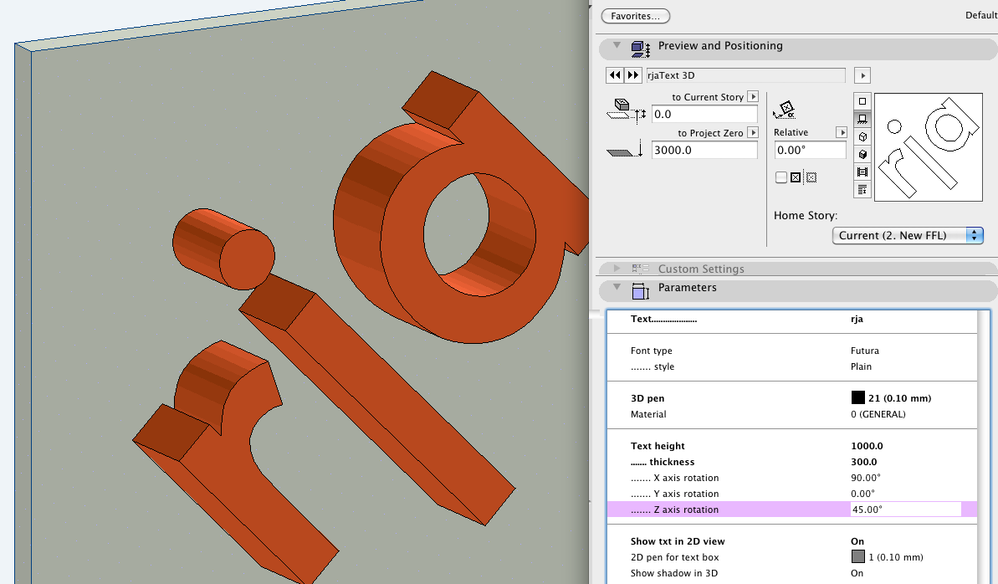

martini-girl wrote:
/..... THANK YOU, but on a 45 degree angle. Kinda so that you have to tilt your head to read it. Like book spines.
Something like this?
Let me know and I'll post a copy of my part.
I have just added the ability to rotate in all 3 planes.
Rod Jurich
AC4.55 - AC14 INT (4204) |  | OBJECTiVE |
Yes Rod!! That looks like you rotated the text 45 degrees up a wall? I want to rotate up 90 degrees.
So how did you do that? I tried to follow what Barry said but I'm too much of a novice (and not to mention completely computer dumb) to figure it out.
So give me the instructions s-l-o-w-l-y lol!

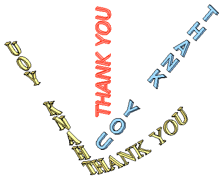

Try the "MultiText 3D" object in the library below.
It should do the trick.
