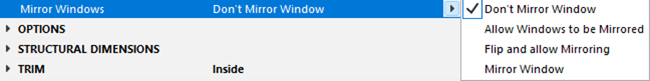

For our windows, our window supplier has the opening sash on the left
so we added the feature to our library part for controlled mirroring.
Note: For a volume home builder 50% of the time you will need to mirror the entire plan.
by customizing the window we added the following to the object
Parameter;
Dont_mirror_windows
Master script;
wind_mirror =1
if Dont_mirror_windows = "Don't Mirror Window" then
wind_mirror = (1-2*SYMB_MIRRORED)
endif
if Dont_mirror_windows ="Mirror Window" then
wind_mirror = -(1-2*SYMB_MIRRORED)
endif
if Dont_mirror_windows = "Flip and allow Mirroring" then
wind_mirror =-1
endif
2D Script;
mul2 wind_mirror,1
3D Script;
mulx wind_mirror
Parameters Script;
values "Dont_mirror_windows" "Don't Mirror Window",
"Allow Windows to be Mirrored",
"Flip and allow Mirroring",
"Mirror Window"
If you are willing to crack open the standard library part and resave it with theses additions then you can control mirroring too.

I note that some of our suppliers Basins only come with the bowl on a particular side and you cant get a mirror version, and some of our tapware cant be mirrored either.
Having an object that can display something that Physically can't be built becomes a problem.
this is our solution, i don't know if it will help you.
