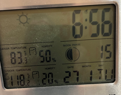

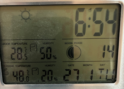

P.S. in Melbourne on Tuesday it was 48C in the shade....
or for our American friends 118F.....
warm enough for the clothes to be dry before you finishing hanging them out.
