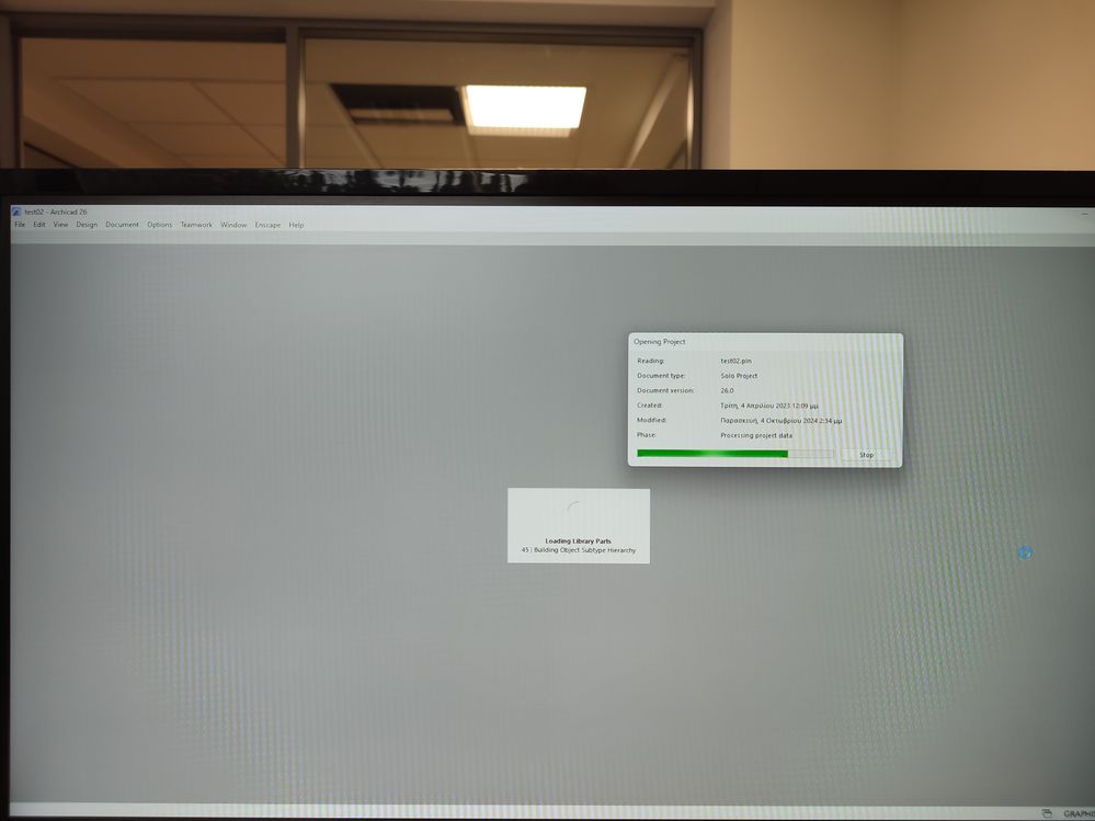

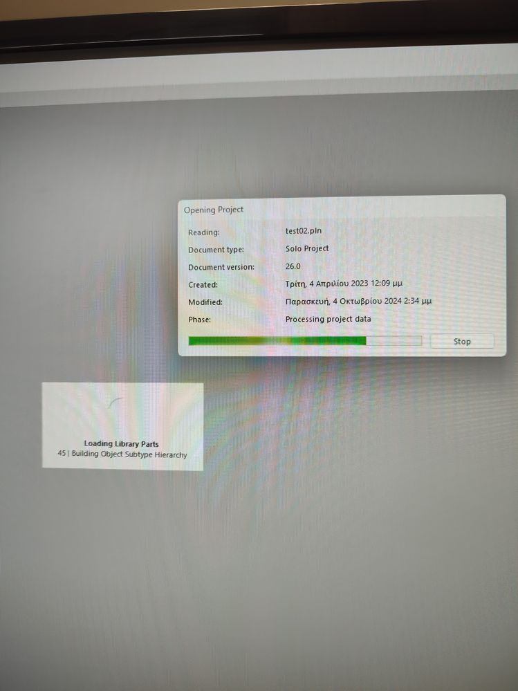

When we load an ArchiCAD file, there is a pop up info box that says what is loading...
Does anyone know what the number 45 on my startup 's popup screen could mean? (attached pictures)
