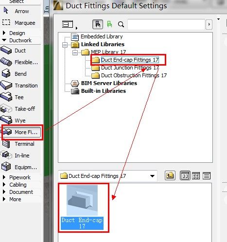

What is the suitable MEP terminator to end the duct? Any suggestion?

Kent Xiao:
If you just want a blank flat termination, then you could make your own using the MEP Connection 16 object and a model element (wall or slab). In the MEP Model User Guide see the chapter Create Custom MEP Part.

Thank you for your advice!
With lucky, I found the cap is available in the library.

Kent Xiao:
Good find! I didn't think to look under the Duct Fittings, rather than the Duct Terminal, for this item. Thanks for posting back.
