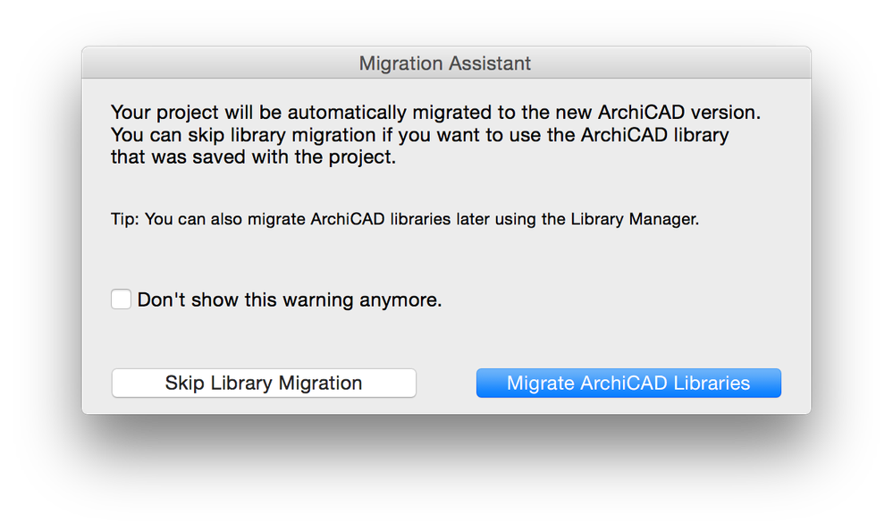

I think you might be skipping a step in the migration process. When opening the old file in AC18 you should get a Library dialog box asking if you want to consolidate libraries. Select yes and AC should process the file and update or link libraries as needed. I think that the reason that some windows and doors don't migrate is to avoid losing information like Dimensions and/or Labels or schedule settings.
