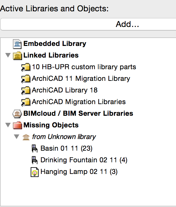

Eduardo Rolon
Now using Library Manager look for AC11 Migration Library within the Graphisoft App folder in "Old AC Migration Libraries" and it should update most of the objects.
The three missing objects are easily fixed.
