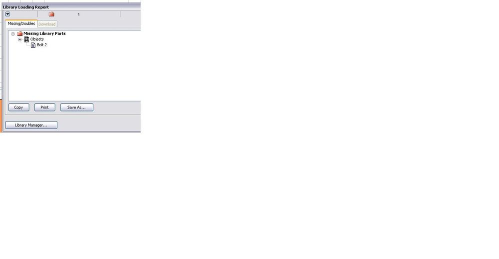

Hi, How can I get rid of this object missing error? It is definitely loaded. Why isn't there a path after the object name?

Hello,
Does the loaded object have correct AC version (not too new)?
Regards, Juha
There is only a path when you select an object that is a duplicate - it lets you see where each duplicate is found. In the case of missing objects...if there was a path, it wouldn't be missing. 😉
How do you know that "Bolt 2" is loaded? The fact that it is missing indicates that it is not. If you go into your Object Tool Settings, can you find Bolt 2 using the 'Find" option?
Are in in AC 12 and is this an object that you created? If so, then you have a GUID problem...

Can you select the Object and use the Open Object command to open it for editing? If it opens try to resave it and lets see if that helps.

Sorry for the confusion.
In context ... that it was missing indicates that it is not loaded. The fact that you find a Bolt 2 object when you 'find' library parts in the Object Tool Settings indicates that indeed you have run into the new behavior of AC 12 which ignores the name of library parts and only uses the GUID.
That means that you have placed some Bolt 2 objects that refer to a library part with a different internal identification number (GUID) than the Bolt 2 object which is actually loaded.
Look through this Wiki article:

So, what you need to do is find all instances of "Bolt 2" in your project using Find & Select. Here's the nightmare that you may run into: some of those may show up as bolts, and others as bold dots (missing object).
Find & Select finds my NAME, even though ArchiCAD does not work by name. Yeah, it is a bit crazy...
So, once you locate the missing dots for Bolt 2, select them (as many as convenient), go into Object Settings and select the Bolt 2 that is loaded to switch to the loaded version. If the object is placed by anchor or has parameters, that will not be enough. Instead of just selecting the Bolt 2 that you see, you will need to inject (cmd-option) into the thumbnail of the Bolt 2 in the lower left corner of the Object Settings dialog to transfer the parameters of the missing objects into the loaded object. Then OK out of the dialog and the change will be complete.
If this is a 3D element, you'll have to open every story to find them all. If it is a 2D element, you'll have to open every viewpoint on which you might have placed it - including sections, details, worksheets, etc.
Again, this 'new' behavior in 12 means that you can have a whole bunch of different objects called "Bolt 2" which AC distinguishes behind the scenes via the GUID ... but which we users cannot distinguish while we're working. So, it is important with your own objects to edit and Save (and not Save As - even if over-writing the same part, or rename, etc) to maintain the GUID and avoid what you are seeing.
I think that if GS felt the need to make the internal changes in 12 that eliminated name-matching, they should have provided a means in the user interface - including Find & Select and the Object Settings Dialog - for us to manage the kind of problem it seems you've run into and which is described in the quote above.
Good luck - let us know how you resolve this.

Thanks for that explanation Karl. Seems the Library problems have been made worse with AC 12, instead of being simplified. Hope i'm wrong about this.
Actually Juha gave me a clue with the versions of the object. I searched the hard drive for Bolt 2 and had about 5 of them. Some were different versions. So I replaced the one I was loading with the latest one and thankfully the "missing" disappeared. Thankyou Juha.
Sorry for wasting your time Karl, hopefully you explanation will help others.
On a similar note with the Library, I made a truss out of slabs etc and saved as an object. Then deleted it. Then I kept getting the "missing" every time I loaded that project. There is no instances of the object in the project. I just restored it to get rid of the library error. Is there a process more than just deleting out of the Library, to get rid of it altogether?
Missing objects are not just those that are placed in a project - they include the default settings of any of the tools. So, if the Object Tool was last used with your truss, it will show as 'missing'. Just select some other object out of the standard library with the Object Tool before saving your file and that will go away. (Happens for all object-related tools: window, door, skylight, wall end, label, zone, etc.)
Glad you fixed the Bolt 2 issue the easy way. 😉
