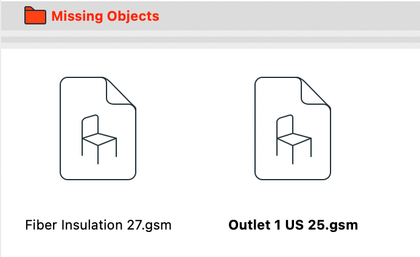

ok, found the sections...they were in a weird folder
but I've now thoroughly covered the favorite folders & I still have two objects left
I can find one called Fiber Insulation that is fine (not the 27 version). And I'm lost on the Outlet...not seeing it in any Favorite folder anywhere.
Is there no way to just delete these references? I can't even select them to redefine them...
If I were to load the old libraries, does that help me delete them somehow?
On a secondary line of thinking, maybe they are actually objects in the file...? How can I search just for those named objects?
