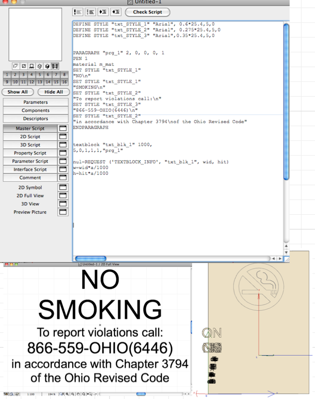

I am trying to make the paragraph center aligned, but AC doesn't seem to like this in 3D, only 2D. Please see the attached image(s). Any other justification besides "1: left aligned" screws up the 3D text.

... and this is what happens when I center align.

That's really strange. I just entered your script into my AC13 (3259) and it works like a charm in 3D.
Of course I used this simple 3D script:
RICHTEXT 0, 0, 0.01, 0, "txt_blk_1"What do you have in your 3D script?

Zsolt,
I have the same 3D script:
Is it possible this is an Int. -vs- USA version issue?
RICHTEXT 0, 0, 1/64",0,"txt_blk_1"BTW, the only alignment code that displays correct in 3D is 'left aligned', all others display jumbled up, but all look correct in 2D.
