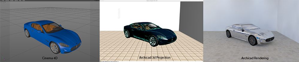

So far our experience in converting .3ds or .c4d into gdl has been an issue. The files we are working with seem to have about 1.5 million polygons and we have been able to get one and only one to convert to some level of acceptability. I have attached a photo of what we see in Cinema 4D and Archicad. We also notice that often on import Archicad keeps asking for files that are associated with the .gds file that are not included in the original and so the attached shows those results. We have even go into Cinema 4D and resaved the file as a .3ds but with no change in the results.

Take in consideration that AC is a program for construction documents not a rendering or regular 3D program like C4D, Maya or others. For construction documents having detailed car objects is not a priority, same with napkins, fluffy pillows, trees etc.
Having said that if by some reason I need to place different car models within the AC file, what I would do in C4D is remove all unnecessary elements from the car model like steering wheel, seats, brake pads, etc
Conceptually I would have my cars have fully mirrored glass so that I can't see inside and have to import unnecessary stuff.
Also in my experience the conversion of some 3D models depend on how they were made originally. This means that some will come in good enough in 3DS but not in DWG or using the "send to Archicad" command from C4D. There is no particular way on how to determine which will work except by trying the different methods.
My usual work flow is to import the file into AC using different methods then I would convert the resulting object to a Morph for clean up and resave as another object.
