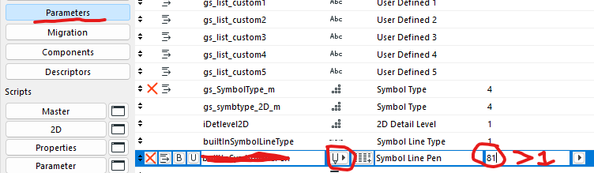

I can't change the setting of this object to publish correctly. It looks very bold at all when publishing. please help

this object is from archicad library. My balustrade is from Customer Library so cannot match the setting. Any other solution sir 😞 ?

Yes, we dont have 45 angle railing so use from AC library. I have looked the setting but dont know why hic

If it's a custom object, can you open the object CTRL+SHIFT+O and change the Pen Parameters.
Make sure you know what you're doing though because you can break the object if you mess around with parameters. But changing pen numbers will be fine.
Alternatively create a new pen set for that elevation layout and whatever pen is being used (6-7) on the object, change the pen weight to 0.10 thickness.
