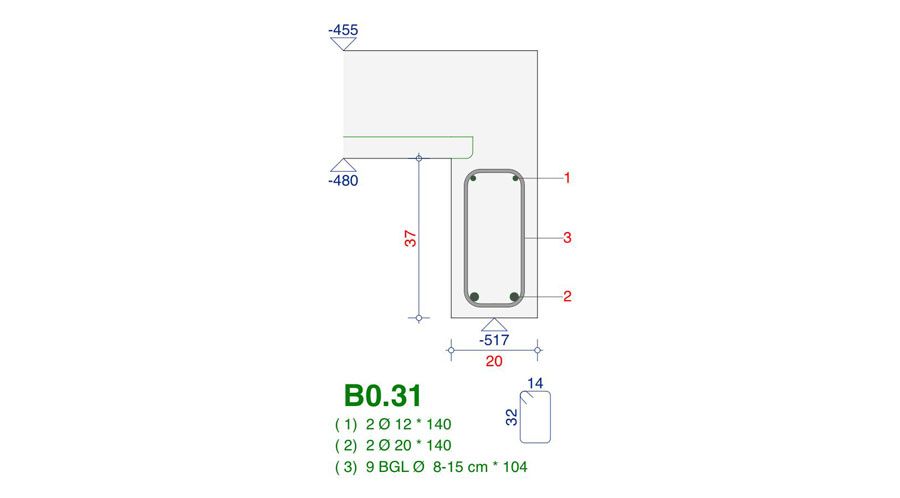

sadones1 wrote:
Can a GDL object know information about the (nearest) slab on top of which it is positioned, in the same story ?
(distance to the slab, thickness of the slab)
Only possible using the ArchiCAD API.

I need the following kind of section (see attachment).
The beam is a GDL object.
The section is generated as a 2D script.
If GLOB_SCALE = 50, the 2D script generates the plan view of the beam, without steel.
I now enter the slab (bottom) level, slab thickness in SCHEDULES and I also draw the slab with the normal archicad SLAB tool, so I enter the same information twice.
For different interactions between beam and slab, the drawing must adapt, that's why I draw the section with a 2D script at this moment.
To Duane,
Your suggestion to place the object at some distance above the top level of the current floor works as suggested.
But the question is :
Can a GDL object access information about slabs on the current story (or the story 1 level higher) to use in a 2D script ?
I'm afraid it's not possible without API ?
