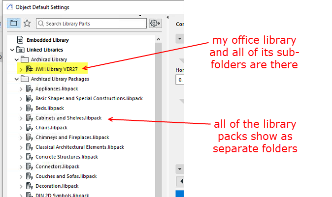

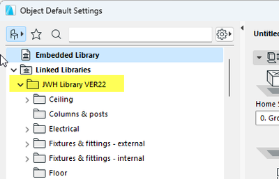

For example my office library looks like this ...
But when loaded in 28 looks like this ...
Where as in earlier version it looked like this ...
You can change to 'Folder View with Sources'.
That will now show the main linked library folder, but will also show the folder of each library pack as well ...
I have mentioned this to Graphisoft during testing, but I am not expecting anything to change (but I am hoping it will).
A simple solution though is to add an extra parent folder to you office library.
So, Office Library > Office Library > sub-folders.
Then link the first parent folder (you won't see that folder name) but you will see the second folder with the same name in 28.
