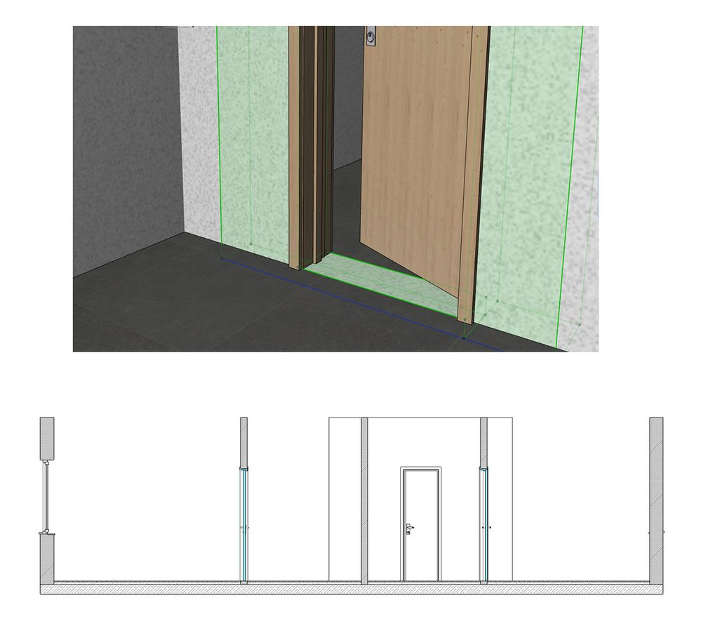

Hello guys,
I'm bumping my head against the wall and can't seem to find a solution to my situation that doesn't include additional elements.
So here is my problem. I have a wall that goes 10cm into the slab below and cuts the finish and screed layers of the slab to reach the concrete level. Thanks to the relatively new Building Materials and their priorities ArchiCAD cuts the slabs alone (not like before when we used solid elements operations).
The result - correct section and no need to go through every wall and bring it to the concrete level.
The problem comes when you put a door. It reaches the finish level and you see how the wall is cut. It is visible in section and 3d and you can see it for yourself on the image.
Is there a way to tell AC to cut the wall beneath the doors smartly without adding additional elements?
