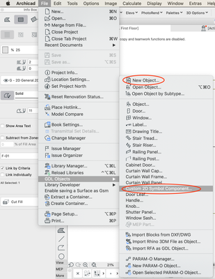

heathldesign:
Be sure to Save As New Object, not Custom 2D Symbol Component.

@Lingwisyer wrote:
Pretty sure that is a bug, as "Placable" is the default option in previous versions...
It is when you save as a new object.
But saving as a 'custom 2D symbol component' means it is saving as a macro to be used in a custom component list (like door leafs).
These are probably not set as placeable as as you would never want to place them on their own.
