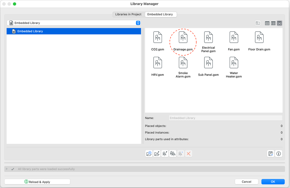

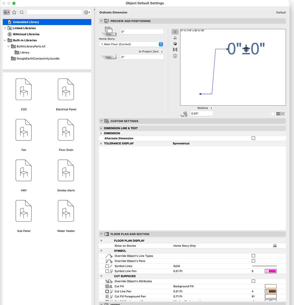

i created a simple 2D object which is in the embedded library when i go to the library manager, but it's not in the embedded library in the objects default settings window, so i can't select it. i've done a search for it but it doesn't come up. see pics

no, it's only two fills. simply 2D. its named, but i can't find it anywhere but in the library manager. when i saved it, it didn't give me any options to save it as any specific object type, other than custom 2D. i still don't understand why it doesn't show in the object settings dialogue under embedded library, but in the same folder in the library manager? and why it doesn't show when i search by name.

So you had 2 fills in plan, you selected them then FILE menu > Library & Objects > Save Selection As > Object.
This will save as an object and it will be in your Embedded Library.
heathldesign:
Be sure to Save As New Object, not Custom 2D Symbol Component.

ok, so i went in to file>libraries and objects>open object and checked the "placable" option, now it's accessible in the objects pallet. there isn't an option to save as placable when creating it. just for fun, i tried to do it as "new object" but that's not intuitive, i'll have to read up on that. i tried it, and didn't see a way to save my new object. not intuitive.

But saving as a 'custom 2D symbol component' means it is saving as a macro to be used in a custom component list (like door leafs).
These are probably not set as placeable as as you would never want to place them on their own.
