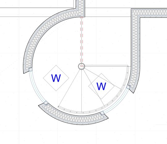

David O
Hi Have you tried the curved window in the special windows section of the library, I have attached a screen shot for an example, I hope it helps!
Regards
David

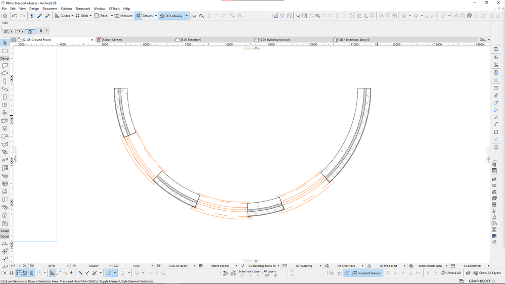

Geof Gainer
Hi David,
How do you get the sides of the curved window to be perpendicular to the walls? When I try it they wind up parallel to each other no matter how I adjust the reveal, see attached.
AC fan since v 7. Currently on AC 28.1.1 (4100) USA FULL, Apple Silicon,. 2022 Mac Studio, 32G ram. MacOS Sequoia 15.5
David O
Hi Geof
I am not sure how you did that I can't replicate it my reveals are always like this in the screen grab.
