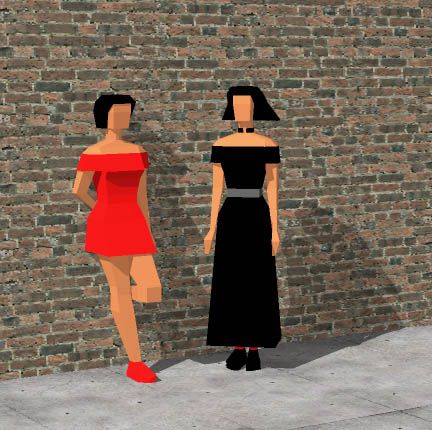

Kate, the Woman in Red Dress, has aged along with the rest of us, but what she lacks in polygons she still makes up for in style. I found her and her Goth sister Vicki in the old "People and More" library from ArchiCAD 6.5. Vicki might be persuaded to wear a white dress for a day or two if you make her the right offer.
Unfortunately they both came into ArchiCAD 16 with lots of error messages and no feet. I converted them to into morphs, added some shoes and loaded them both into a single object file with parameters for positions (standing, walking, leaning) and materials.
Look for "Woman in Red" in Bim Components.

This is very strange. The new script was generated entirely by ArchiCAD 16.
I can find instances of both the ".e" and the "e" exponential notation in the 3d script, but no error messages here.
vert 0.0401, -5.e-5, 1.54412 ! #239
vert -1.73472e-18, 0.0771071, 0.999941 ! #240
investigating....
