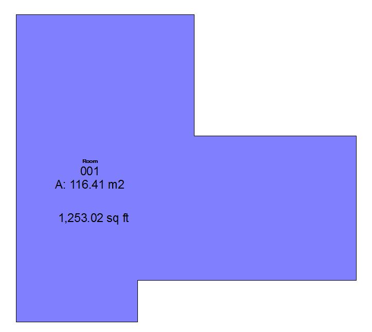

I don't have a good solution but it can be done like this.
What you see below is two drawings in the Layout Book. The drawing on top is a transparent fill with units set to display decimal feet. The one with the zone stamp has units set for square meters.
You can select the units to dispay each view in View Settings. To open the View Settings, right click on a view in the Navigator.
