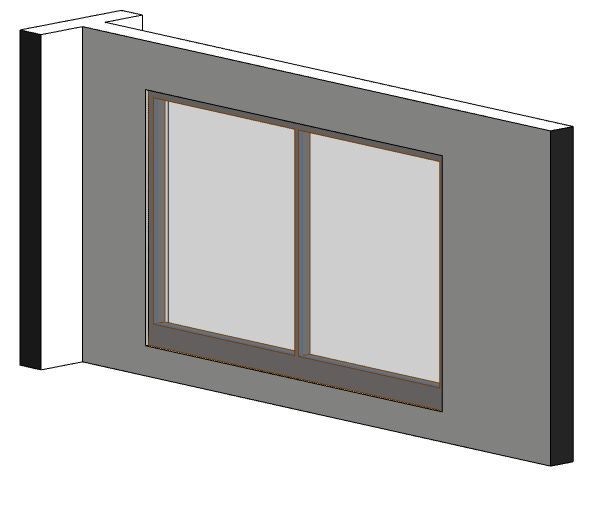

How can I change the bottom mullion dept at the sill on the storefront window? There seems to be a setting for everything else except that element. I hope it's not a default that can't be changed.
Otherwise, how do you put in a storefront window. Curtain wall is a wall and won't punch a hole in the existing wall.

Under All Parameters > Frames > Bottom Rail Width. In AC19 this parameter has been added to the Shape and Panel Divisions... panel.
To use a Curtain Wall, just add an Empty Opening (Simple Window Opening) to the Wall, then place the Curtain Wall in the opening, which is my preferred method.

Got it. Thanks.
