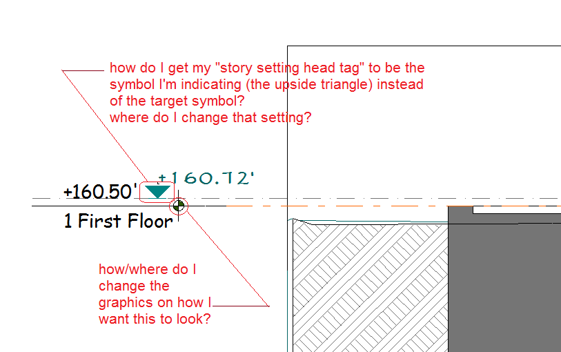

formworksdesign wrote:
Try:
Object Depository
01 General
Elevation Dimensions Marker
Author: BeArt
Style 3 within object for "upside down" triangle
May be compatible with 18.
‎2016-04-21 04:49 PM
‎2016-04-21 05:05 PM
‎2016-04-21 05:15 PM
‎2016-04-21 05:17 PM
‎2016-04-23 04:50 AM
rob2218 wrote:Robb:
ok, man...do I need some basics here...ok I found the object but it's an LCF file in a winzip file.
I've extracted the LCF to a folder in my PC...now what?
