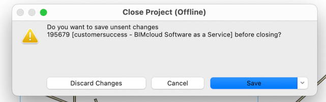

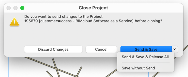

My suggestions:
  • Should we all leave the project open till service is restored?
    You can keep the project open; however, as some people mentioned in later replies, there could be short-term issues with the project where a restart is needed. There is also an option to save it to the local cache and just close the project.
          And you'll see them displayed like this when you re-open them:
  • Do we save it locally?
    Definitely. If there is a crash, or any inconsistency between the server and client computers later, it can be essential. It's always better to have PLNs that you can delete later than losing data.
  • Can we close and reopen it tomorrow morning, and will each individual local data resync once we all log back into the project?
    Synchronization happens when you hit 'Send & Receive'. There is no automation here, no matter if we talk about on-premises or SaaS.

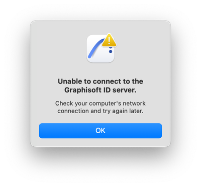

Is the Graphisoft ID server down again?
I haven't been able to get a license this morning.
I tried re-starting my machine, and also signing out my Graphisoft ID. But now I can't sign in.
Obviously, my computer is connected to the internet, since I'm posting this.

Stuart Smith
The issue was with local IP filtering software from my ISP  (Fidium Fiber).
It decided to block .graphisoft.com traffic. Except for the website, so maybe only certain ports?
Apparently it's "powered by AI" so you know *rolls eyes*
I don't control the router here (it's the landlord's) so I didn't see the settings.
Anyway, something to look out for if your license key stops working randomly.
