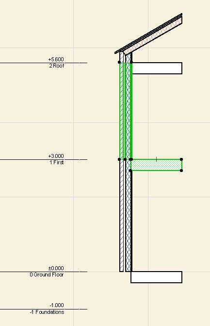

I'm going to disagree with Dwight (again! Sorry!) Do not set it all up on one floor! As a beginner you will want to use storeys to set up the building; they are simple to use. Get into the habit of doing it correctly. Doing it by layers is too complicated and has greater implications elsewhere. Also ignore the floor plan cutplane at the moment, leave it as the default. Use the 'Home Storey Only' and 'Symbolic Cut' floorplan display modes for the walls which will look correct the majority of the time. These are found in the walls settings.
Model the building so the top of each the floor is at the 0 level for each storey and 'hangs' underneath. The walls will start at the 0 level and go upwards. The picture below shows the typical placement in section.
Creating the outer wall of a building can be done by either using single storey high walls on each floor as I suggest above, or using multistorey high walls that pass through both floors. You can do it either way to be honest. They both have benefits over the other depending on the situation. You can even use both ways if necessary! Use the 'All Relevant Stories' and 'Projected' display mode for multistorey walls.

Try setting up the storeys in a similar way to my last image. The lines and text on the lefthand side indicate where the storeys actually are.

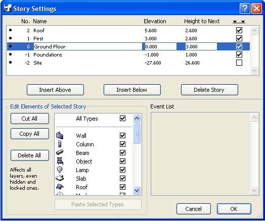

Ok, Instructions right from the start just in case!
1. Set up the storeys correctly. A quick way to access the storey settings is to right-click on any of the existing stories listed in the navigator (The long list of storeys/sections/elevs/etc). You should consider the measurement is taken from top-of-floor to top-of-floor. (Doesn't really matter whether it's finished floor, or structural floor at the moment.)
You can see the ground floor always starts at 0.000m. Work upwards adding a height to the next. You can rename the storey names for easy reference.
Ignore the 'edit elements of selected story' for the moment. I find it best to copy and paste elements directly on the floorplans
Ok, this is what I got :
And sorry about the image, I can't get crop to work in preview ( Mac )
