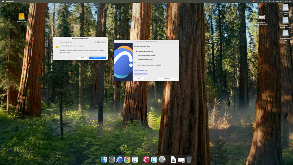

pstady
Logged in. Says "no valid software key found for this user"  
Now what???? T
