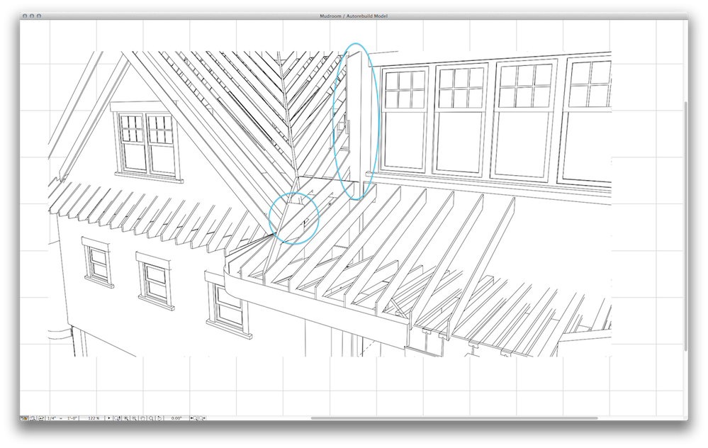

attached is a 3D window view and the 3D document I made form that view,
You will notice in the circled area that the wall is operated on in the 3D view so it is eliminated, but in the 3D document it appears to show up in some strange way.
Any thoughts?

here is the 3D window view

In 3D document, right click and open 3D Source and change the 3D window to internal engine and see if you see these extra bits.
In 3D document, turn on colours (uncut own surface colours) to try and determine what those bits are.
Are they selectable in the 3D document and what element do they belong to if you can select them?
Hope that helps.
