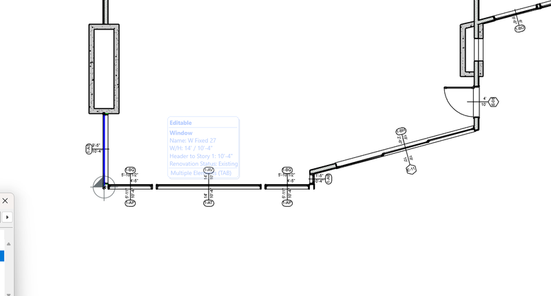

BrandoArch
I had looked into that. The origin point is on a corner of the building (typical). I have removed unnecessary modeling in space. Normally, I work in 3D with the mesh off. The mesh is approximately 3,554 ft from one corner to another. Will objects that are spread over larger distances affect this, even when their layer is off. Is so, would the size of this mesh be large enough to make this difference?

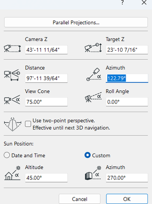

Lingwisyer
Guru
I have had much bigger meshes without any issues.
Check to see if your Perspective focus Distance is not a million miles away.

BrandoArch
Does not seem to be the origin point or focus point, but the symptoms do seem to point to things of these natures. When I select "zoom to fit" I am zoomed very far out from the model. Suggestion appreciated.
BrandoArch
I brought in the cut window and this seems to have a big difference. It did not seem to make any difference on graphic's issue when zooming close.
