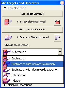

My Tipp is: do that all with "Solid Element Operations...", using substruction tools.
So you will spend a time. Also with "SEO" will be easier to modify in future.

I have found that often solid operations performed on meshes are lost; I have to frequently re-do solid operations - especially ones done with a meshes as both targets and operators. Anyone else see this problem?
