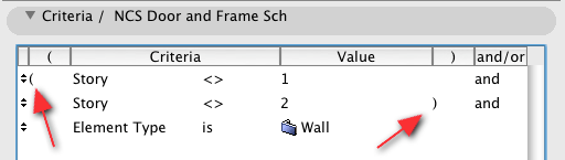

In ArchiCAD, the parentheses would be entered like this:
(story <> 1 and
story <> 2 )

Attached is a screenshot of the new Find and Select dialog in 13, showing the same use of de Morgan's law as in the last example.
Annoyingly, we still cannot filter by Story in this dialog (the Scheme Settings allow much more powerful filtering ... and so remain a superior method for simply locating certain kinds of elements).
So, in the screenshot, I use the layer field to illustrate. Note that there are no parentheses in Find and Select. This also limits its power compared to Scheme Settings as you do not have full boolean logic here. All comparisons related to any particular field must be adjacent and are assumed to be enclosed in parentheses.
